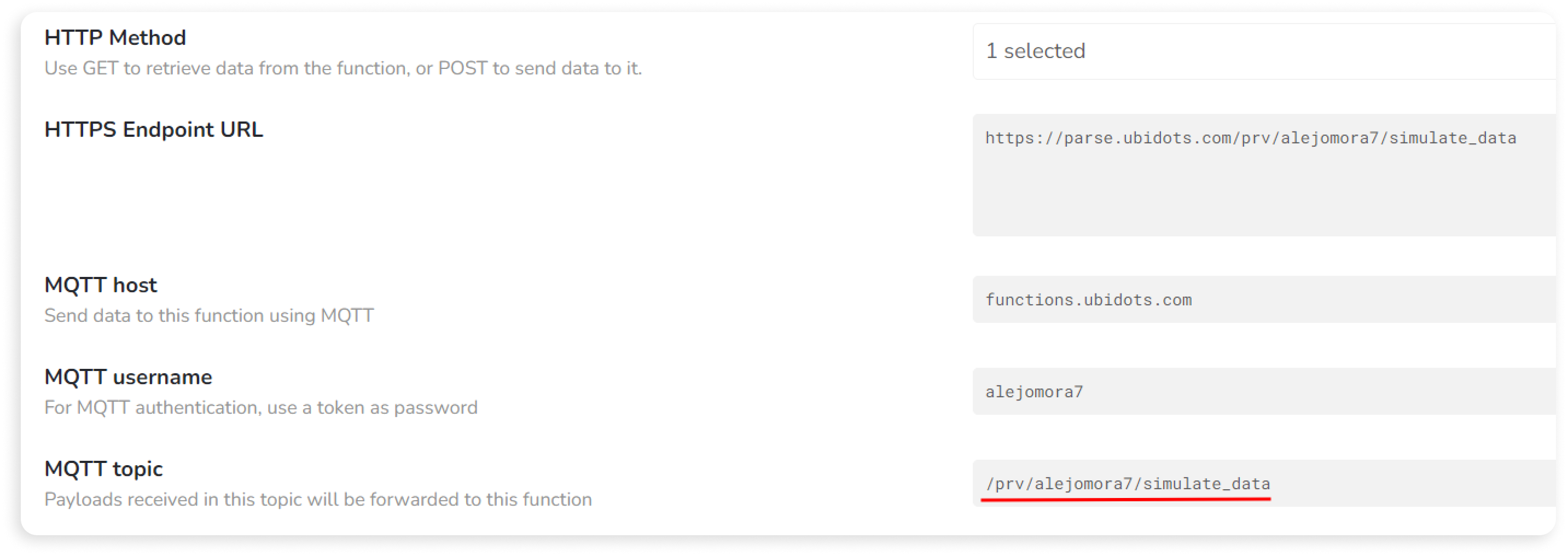

The **MQTT** card in **Settings > Invocation** shows the values for your function, each with a copy button:
<figure><img src="https://884329393-files.gitbook.io/~/files/v0/b/gitbook-x-prod.appspot.com/o/spaces%2F-MhzNRg0B4ECiNXc093G%2Fuploads%2Fgit-blob-3767e0eec7179a7b4002ebef45ca12fb5809e915%2Fubifunctions-settings-mqtt.png?alt=media" alt="MQTT card with Host, Topic and Username"><figcaption></figcaption></figure>
These are the settings to call a function over MQTT:

| **Topic**     | `/prv/<your-username>/<function-label>`                 |

To trigger a UbiFunction through MQTT, the publish topic must follow this structure:
/prv/<username>/<function-label>
Where:
* `<username>` is your Ubidots account username.
* `<function-label>` is the function name in lowercase, with spaces replaced by dashes.

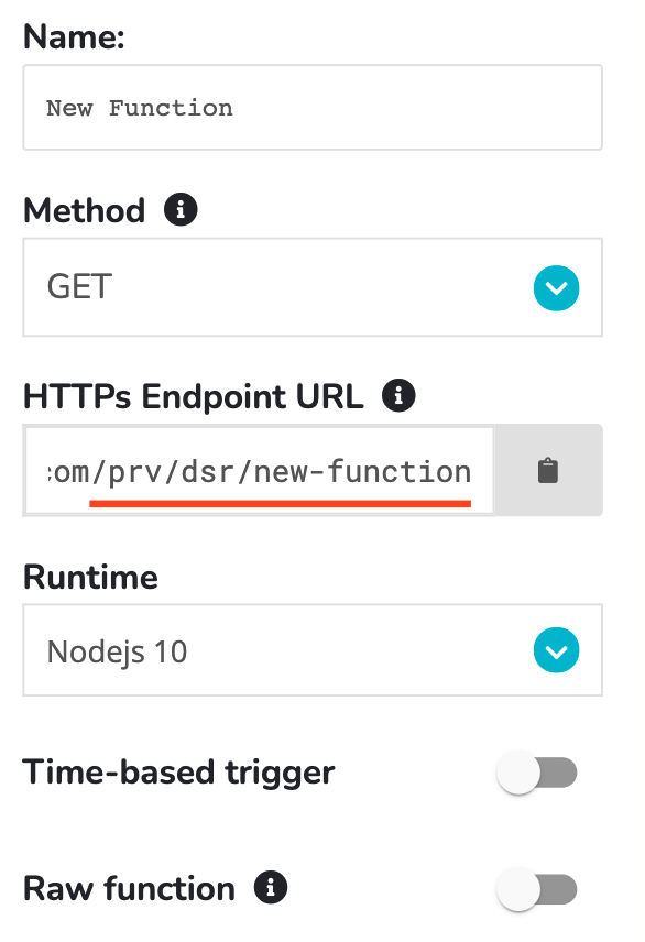

The base topic is the same as the path of the function's [HTTPS endpoint URL](https://dev.ubidots.com/ubifunctions/invocation/https.md#endpoint-url).
