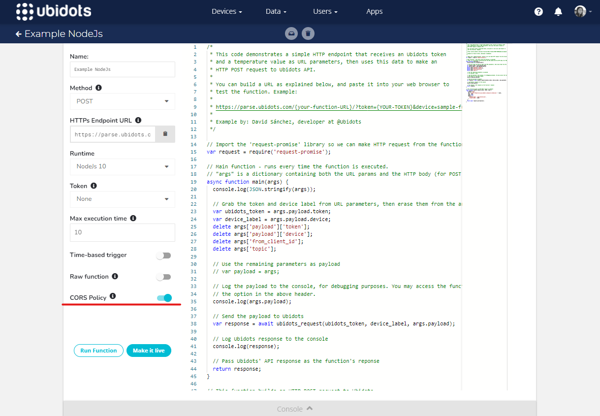

To enable a CORS policy for a UbiFunction and allow calls from web browsers or the HTML Canvas widget, follow these steps:
**Step 1**: In the Ubidots header, go to **Devices** and select **Functions**.
**Step 2**: Open an existing UbiFunction or create a new one.
**Step 3**: In the UbiFunction settings, enable **CORS policy**.
**Step 4**: Click **Save**.
<figure><img src="https://884329393-files.gitbook.io/~/files/v0/b/gitbook-x-prod.appspot.com/o/spaces%2F-MhzNRg0B4ECiNXc093G%2Fuploads%2FmZ6mDtu5E5ccPFsgP0CY%2Fimage.png?alt=media&amp;token=ef53373e-4284-4621-be6f-c11c3801d96d" alt=""><figcaption></figcaption></figure>
