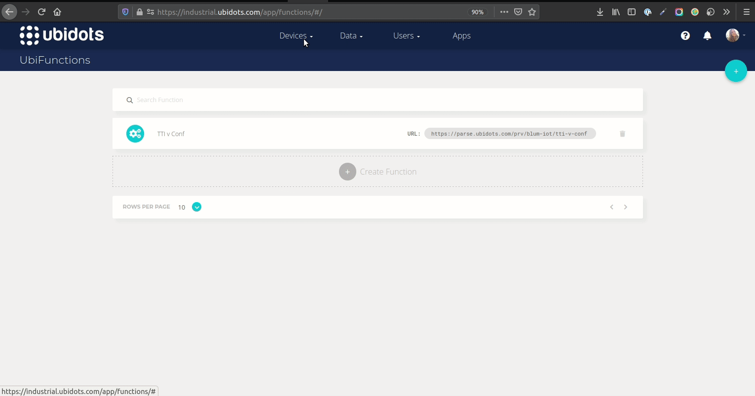

1. In your Ubidots account, go to **Devices** and select **Functions**.
<figure><img src="https://884329393-files.gitbook.io/~/files/v0/b/gitbook-x-prod.appspot.com/o/spaces%2F-MhzNRg0B4ECiNXc093G%2Fuploads%2FhC9YNnHQi8juiu0FW6jP%2Fimage.png?alt=media&amp;token=a8aead75-45d6-4377-8de1-65b7e1296576" alt=""><figcaption></figcaption></figure>
2. Click the `+` icon to create your first UbiFunction.
<figure><img src="https://884329393-files.gitbook.io/~/files/v0/b/gitbook-x-prod.appspot.com/o/spaces%2F-MhzNRg0B4ECiNXc093G%2Fuploads%2FnDxkB7Bmc9CwV9KXsUo5%2Fimage.png?alt=media&amp;token=0027695d-48e0-4c00-94dc-fffd37b7f9fe" alt=""><figcaption></figcaption></figure>
