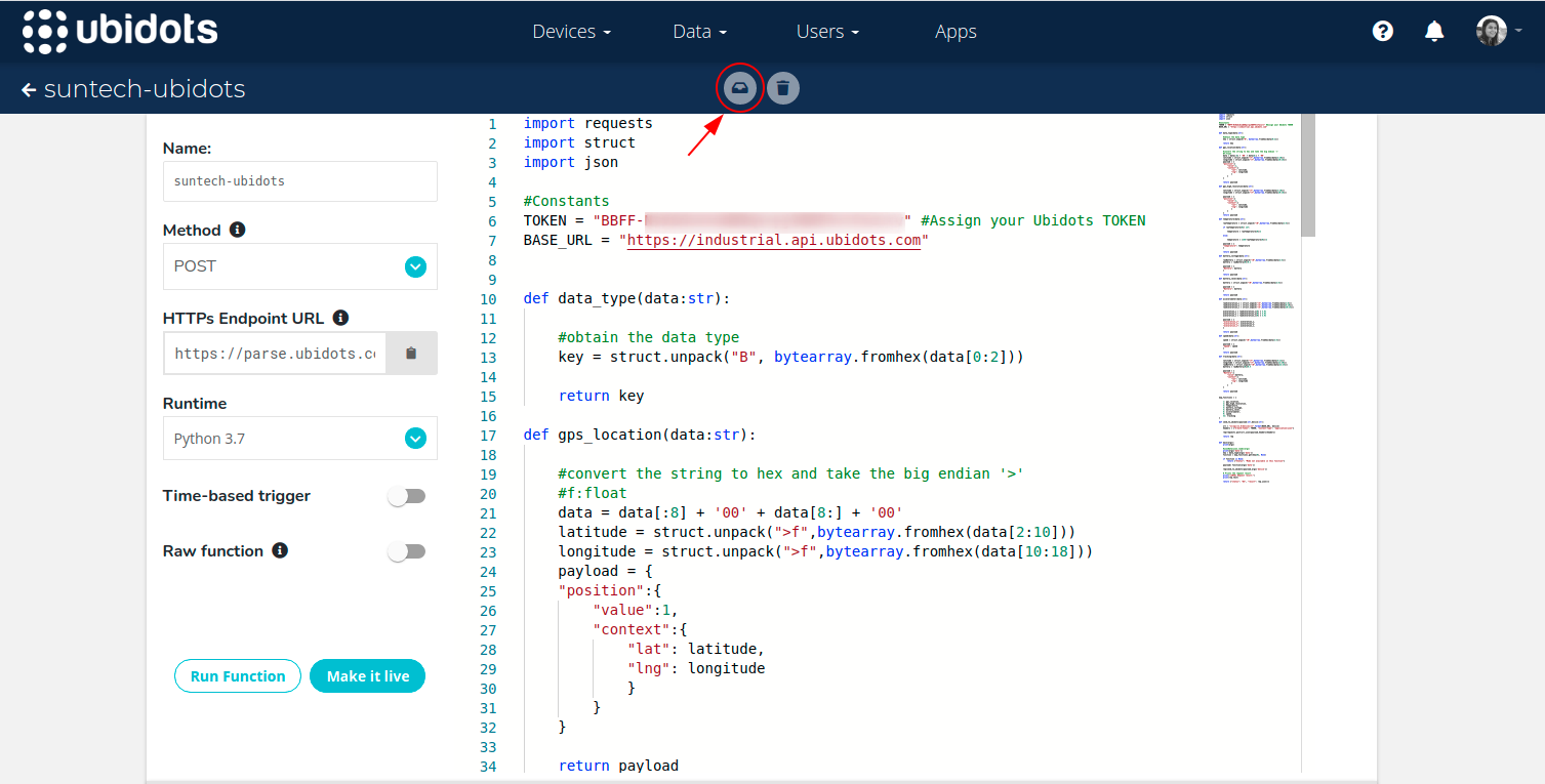

A great debugging resource is the ability to view your function logs. To do so, go to the left sidebar and select the **Logs** icon, as shown below, to view your function's execution history:

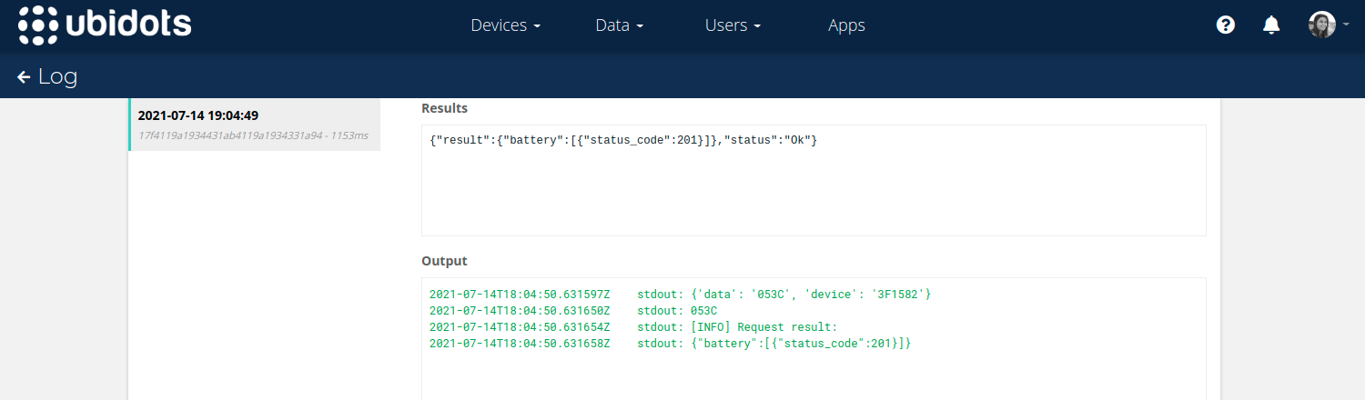

In the function logs, you can confirm that data was successfully posted to Ubidots with the **201** response code:
<figure><img src="https://884329393-files.gitbook.io/~/files/v0/b/gitbook-x-prod.appspot.com/o/spaces%2F-MhzNRg0B4ECiNXc093G%2Fuploads%2FZwOMVcVvsB14lIhZbTb0%2Fimage.png?alt=media&amp;token=0573fc87-c245-49f2-b911-a7dc3d88bfa1" alt=""><figcaption></figcaption></figure>
This is what your function returns. It must be in JSON dictionary format. In your code, make sure to use **return** to exit the function and return the dictionary.
<figure><img src="https://884329393-files.gitbook.io/~/files/v0/b/gitbook-x-prod.appspot.com/o/spaces%2F-MhzNRg0B4ECiNXc093G%2Fuploads%2Fw9115XwiecGDz4qy299a%2Fimage.png?alt=media&amp;token=e30d6203-d4a9-4ab8-a008-c0580a2c56f8" alt="" width="257"><figcaption></figcaption></figure>

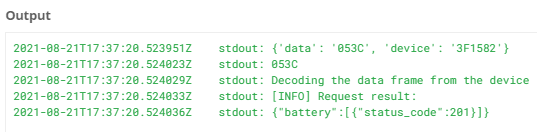

You can also use logs for debugging. Print any variables defined earlier, or print any message that needs to be displayed to the user.
<figure><img src="https://884329393-files.gitbook.io/~/files/v0/b/gitbook-x-prod.appspot.com/o/spaces%2F-MhzNRg0B4ECiNXc093G%2Fuploads%2FR1obT6T7PQBvTQNRUG9W%2Fimage.png?alt=media&amp;token=bf2fdd05-aad7-4b92-affa-2878a88ddea6" alt=""><figcaption></figcaption></figure>
{% tabs %}
{% tab title="NodeJS" %}
```javascript
console.log("[INFO] Request result:");
console.log(response);
{% endtab %}
{% tab title="Python" %}
```python
print("[INFO] Request result:")
print(req.text)
{% endtab %}
{% endtabs %}
