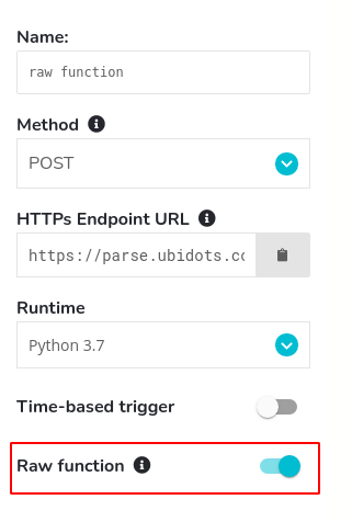

To enable **Raw functions**, toggle the option in the left-side settings section of the UbiFunction.
<figure><img src="https://884329393-files.gitbook.io/~/files/v0/b/gitbook-x-prod.appspot.com/o/spaces%2F-MhzNRg0B4ECiNXc093G%2Fuploads%2FQoejxSduVE2PfdIFFowB%2Fimage.png?alt=media&amp;token=a4357876-25fe-4d4c-9666-f6c9b660732a" alt=""><figcaption></figcaption></figure>
