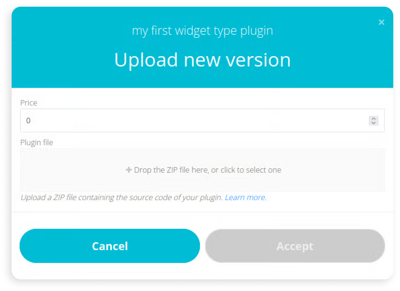

Click the *Add new plugin version* icon, as shown above. A dialog opens for you to upload the ZIP file that contains the plugin files mentioned in the *Plugins development* section:
<figure><img src="https://884329393-files.gitbook.io/~/files/v0/b/gitbook-x-prod.appspot.com/o/spaces%2F-MhzNRg0B4ECiNXc093G%2Fuploads%2FlN9Op7DWs3uEPgOAfNpn%2Fimage.png?alt=media&amp;token=790c2ea0-5902-4184-a5c2-a5aace5d7a3a" alt="" width="563"><figcaption></figcaption></figure>
